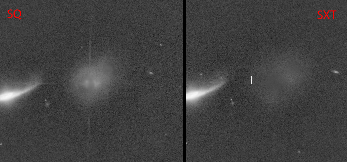

The latest Axiom 3 engine version is out and I happened to try it on an image I am working on with a bright pair of stars. It can be better in some situations than SXT but is basically pretty much a total fail for bright stars with diffraction spikes. Neither it nor SXT is perfect in this tough case but SXT is still quite a lot better.

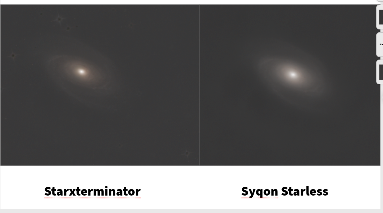

I got some interesting interesting results on my test where I compared Syqon Starless latest version in Siril to StarXTerminator normally used in Photoshop. As far as I could I kept all my processing steps identical. The StarXterminator image had clear artifacts where stars were before, both halos and diffraction spikes were left on the image.
The SyQon Starless version removed these cleanly with no visible artifacts. On a galaxy target (M81 Bode’s Galaxy) I found SyQon clearly superior. Her are the comparison images:
Screenshot 2026-08-31 175804.pngI hope you can see the artifacts in the starxterminator image.
I showed the full test in a recent YouTube video if anyone wants to see the complete side by side results.
