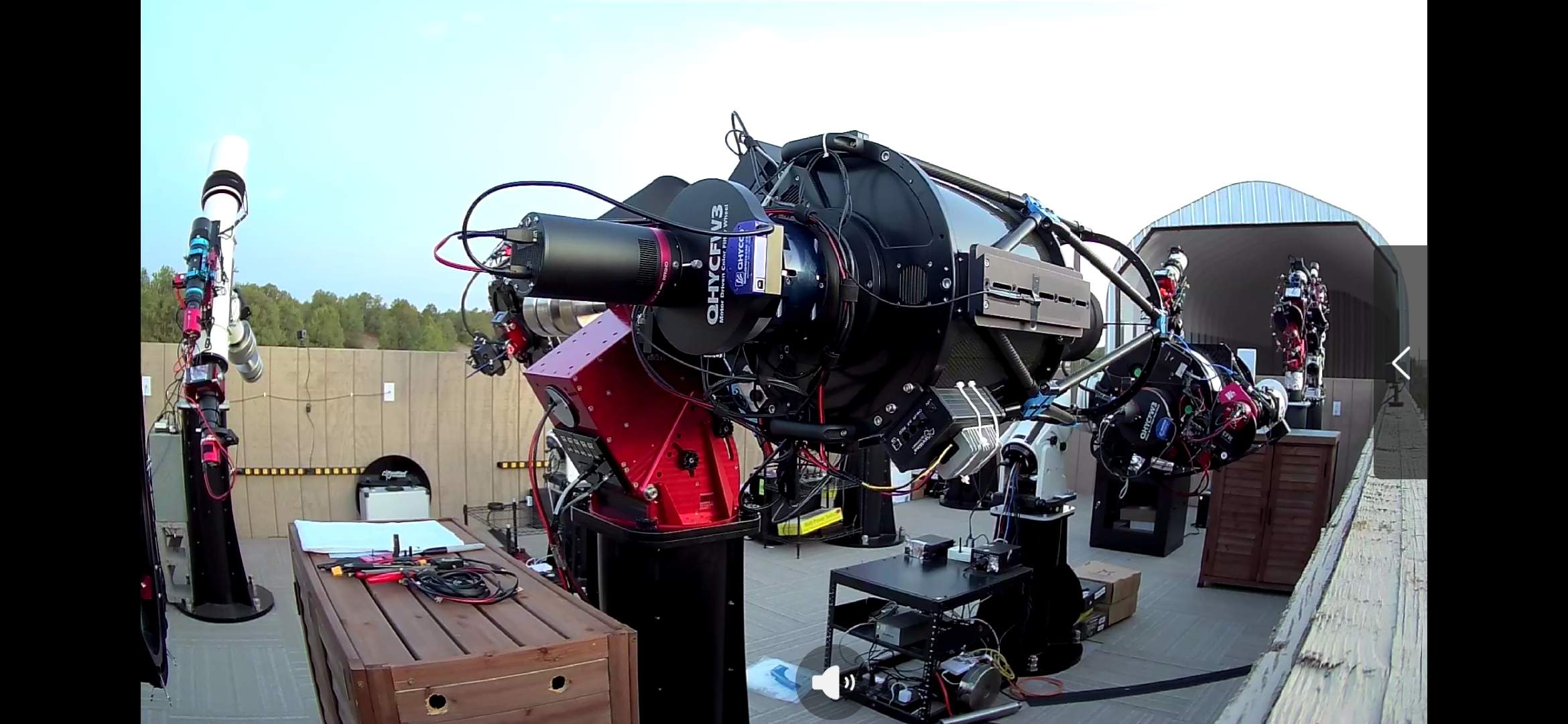

Pete Bouras avatar
Moonlite supplies the adaptor that bolts the focuser to the CDK backplate in the same spot where the Hedrick bolts on. Installation is dead simple. 3 bolts to remove the Hedrick, and the same three bolts to install the Nitecrawler.
📷 2765.jpg2765.jpgYes it is a bit pricey but other solutions are similar or even more expensive, but consider the caliber of the scope its going on, and the focal length, you need precision. In the future as you enjoy the quality and the function of the 3.5 Nitecrawler, the price will long be forgotten
