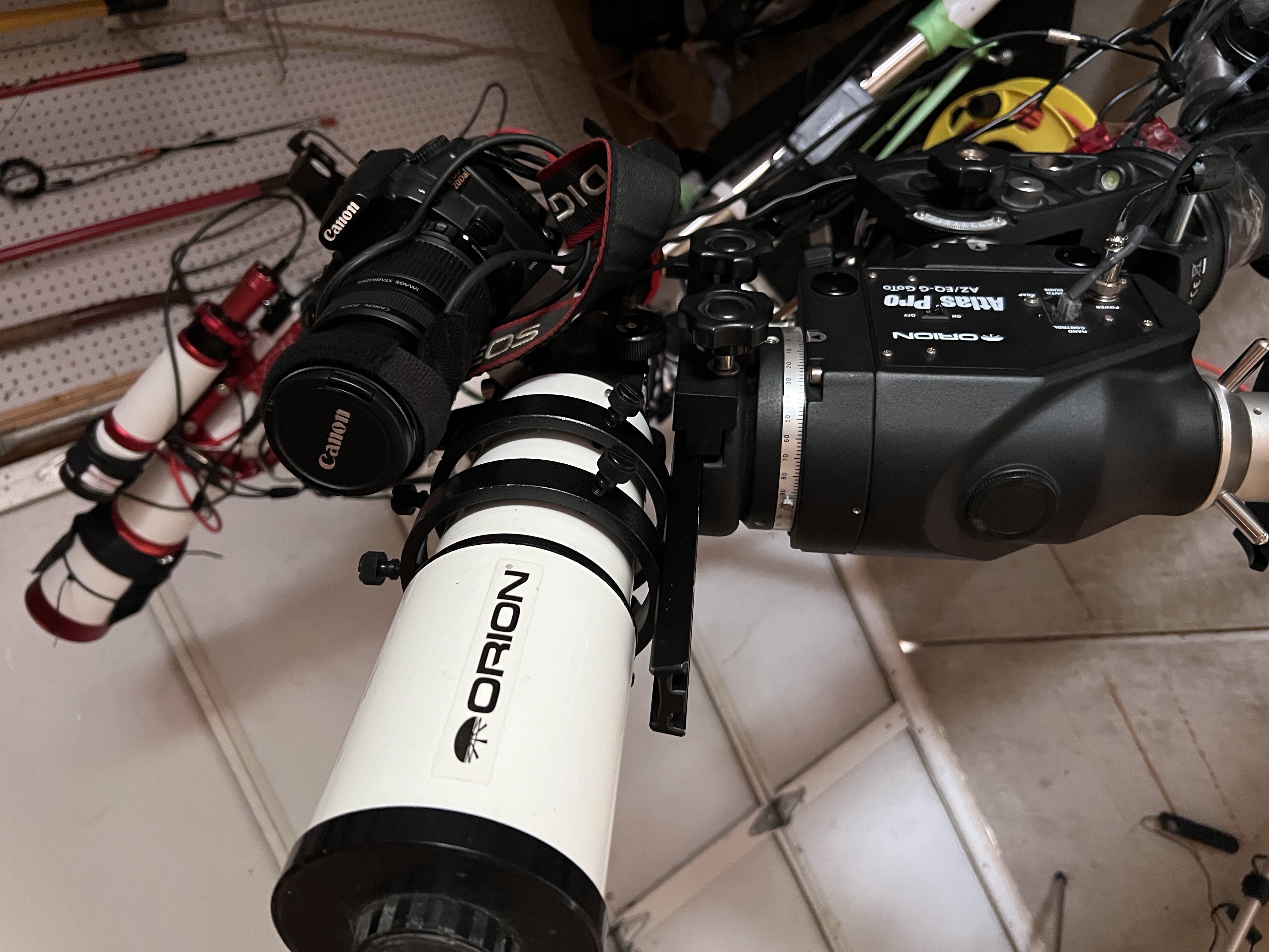

I need to know if anyone can fix my Mount that is located in Midwest of America specially in Wisconsin. The problem I have on the go to run. I’m not sure if it needs any tuning or any gear replacement or maybe the mother board update.
me advise where I can go with this problem to have a solution
clear skies.
R.D.

Can you explain your problem more?
There are guides online for rebuilding the EQ6 (Atlas EQG as well). It’s not extremely difficult. There might be an amateur local to you who would be willing to help.

Hi
I don’t know if I can post a video here that would be a best explanation
Any I make the mount to go to will get stuck only in one area is like 45 degrees angle on RA
But it does happen when moth motors are running RA and DEC
How do I know because when I use hand controller using only RA or only DEc it doesn’t do the problem .
As I did use hand controller at the same time RA and Dec then it di get suck
By saying stock means stop ruining and and gives up to go to .
Chat grips telling me power supply might be week but I see to be 12 volt 6amp
As far as local astronomy clubs I haven’t visit them for long time .
I have to meet some people there and ask questions that’s a good idea .
Thanks .

If the power supply is weak, you will see the mount LED flash multiple times. The codes are listed in the manual. Depending on your connectors, they could have weak contact.
Theres a possibility your worm gear may not be meshed properly as well and you’re getting stuck in a specific spot.
Here’s a trusted guide on how to adjust the gear mesh if you want to attempt it:
https://www.astro-baby.com/EQ6%20rebuild%20guide/EQ6%20worm%20alignment.htm
Definitely I’ll give a try
Thanks so much .
Refet.

I called Sky watcher and asked .
They told me never do hyper tuning on the mount only Only warm adjustments.
Or check my power supply
Brian Puhl avatar
This is correct. Worm adjustment is typically a seasonal thing, temperature can affect the mesh of the gears.
Hyper tuning is nice but not required for optimal performance.

Number one here I learn from you to correct my spelling as I wasn’t sure to call it warm or worm haha thanks on that the question is now how can I do it myself any you tube video suggestions there ?
Thanks
Refet.

Worm adjustment is in the link I sent you above

I see that .
I can give a try hopefully is similar to the mount I have .
Thanks .
