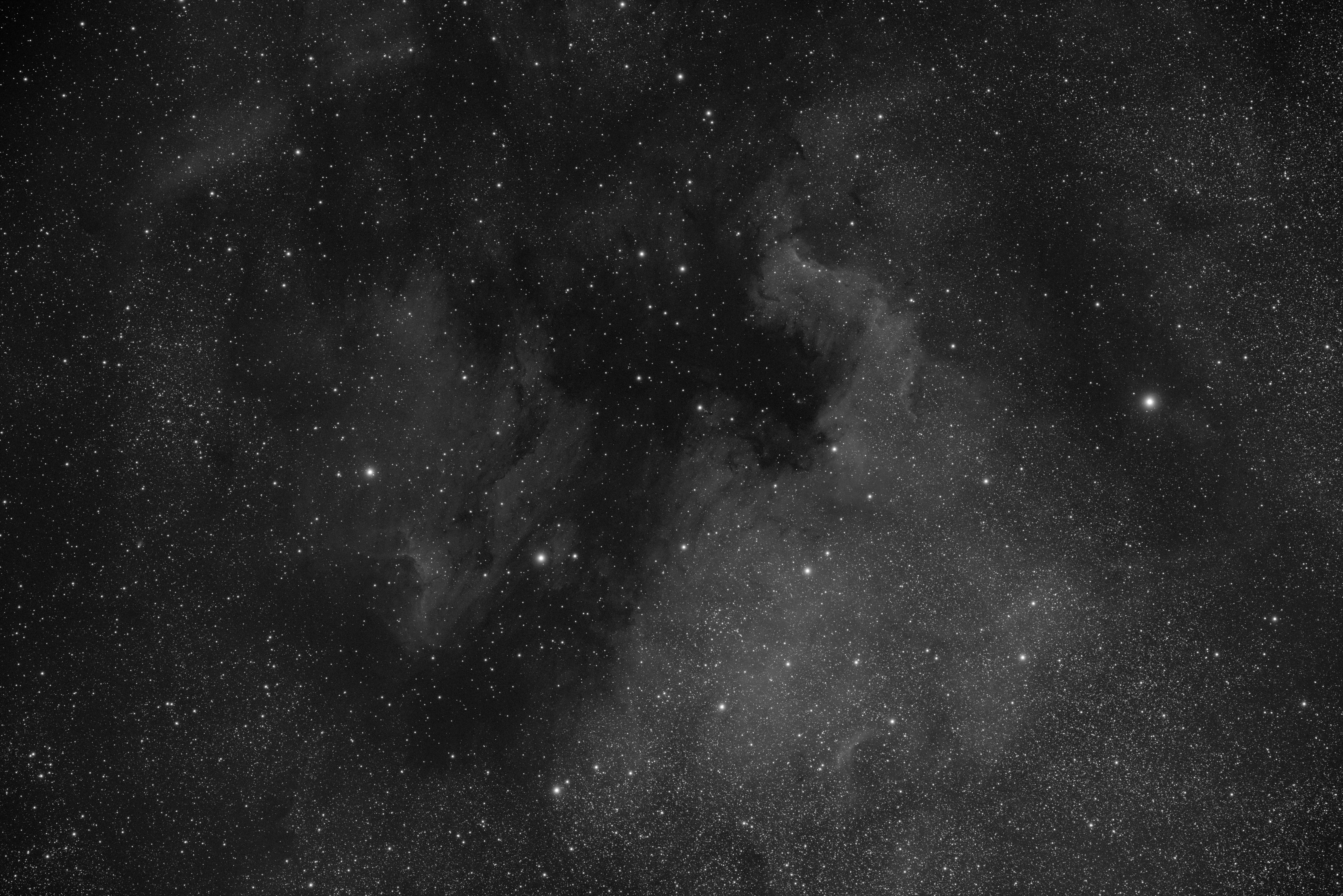

Any thoughts on what might be causing the off-center faint halo around bright stars? This is a single stretched frame with no calibration done to it only a simple adaptive stretch. The issue is clearly seen in the bright star in the right side of the frame where the halo is off-set away from the center of the frame. 📷 test.jpgtest.jpgThe particulars are:

This issue shows up on all filters. The issue shows up on all bright stars and the off-set seems to be proportional to the distance away from frame center.
Any help greatly appreciated.

Andrea, not disagreeing but don't straight filter halos typically show up centered around the bright stars? This is clearly skewed away from the center of the image frame.

Depends were the reflection occurs. In refractors there is path length dependency on wavelength as well as (in doublets as well as in some of the triplets out there) magnification dependency on wavelength, hence the off center effect. Yours is a fast doublet, and as good as it might be, I guess it is to be expected for out-of-focus images. At any rate the test is simple to make, just remove one filter and see if the effect persists, hopefully not.

It will 100% be your filters. They are off center based on how far off axis the star is in the image… if you put the star in the top left, the halo will be see off centered towards the top left of frame. If you put the star bang in the center, on axis, the halo will be centralised… you can prove it to yourself by measuring the halos size in pixels and calculating the distance from the sensor that the halo is… it will be on either your filters rear face, or on the internal corrector lens, reflecting off the filters front face.

Thanks Alex/Andrea! I agree and have reached out to Antlia for their input. I’ve been pretty happy with the regular Pro filters on my iDK and when I go out to install the new FSQ, I may try swapping the filters between the two to see if I can live with things.
