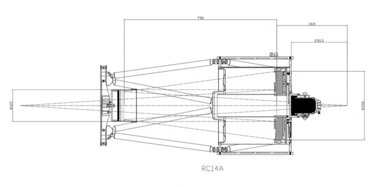

This scope was bought in 2016 with the badge “HIGHPOINT”, this is the iteration right after GSO decoupled the focuser from the primary. I have email GSO requesting a drawing.
I have found this diagram where all the measurement are detailed well. I am hoping this actually accurate
